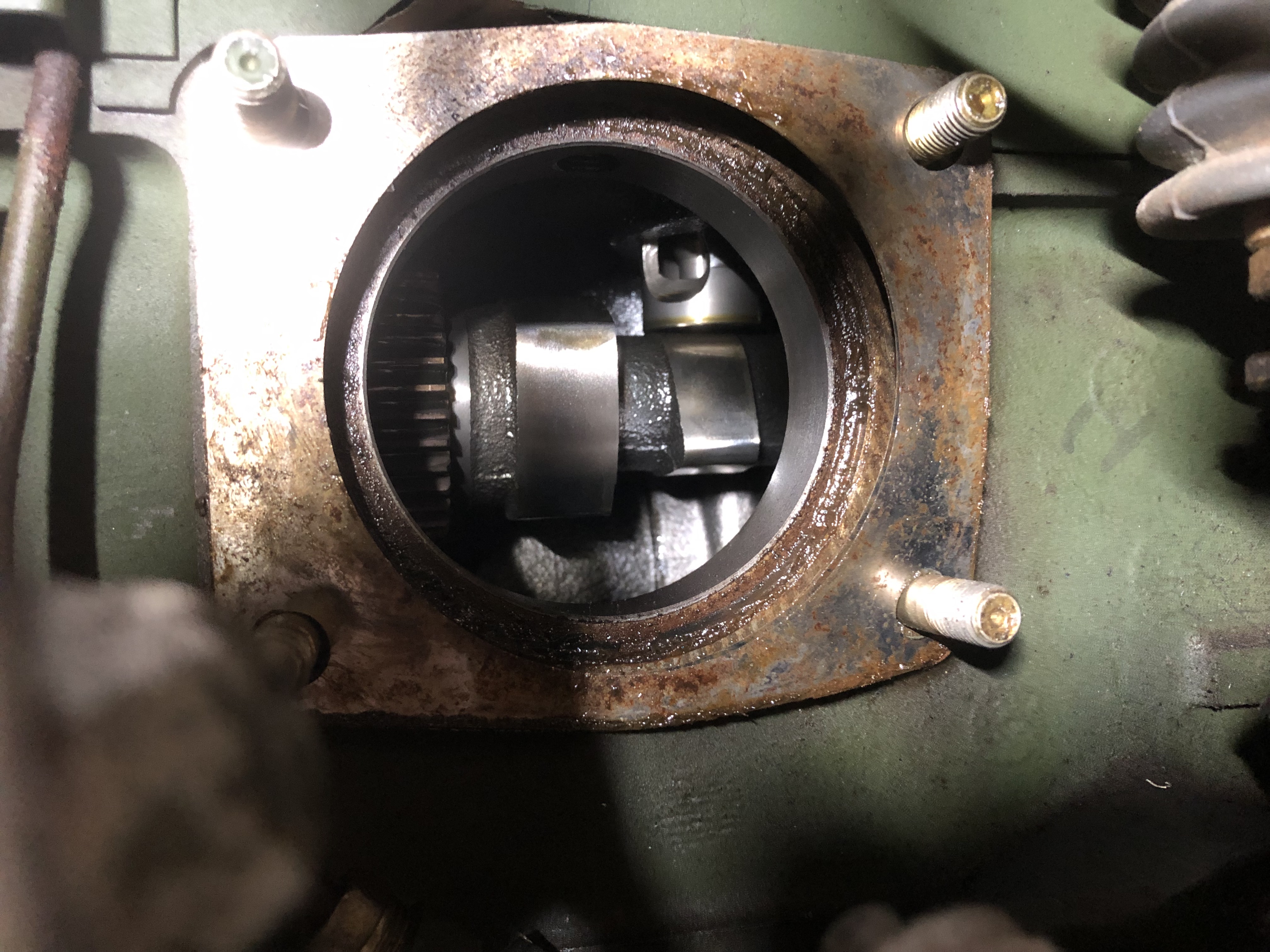

This post deals with the Injector Pump. Here is all the info related to the Ambac M-50 Injection pump as well as a picture to easily identify the non-supported American Bosch pump.
A quick note: The MEP-002A and 003A Technical manuals all show the American Bosch Injection pump. There is no reference to the more common and easier to service Ambac M-50 pump

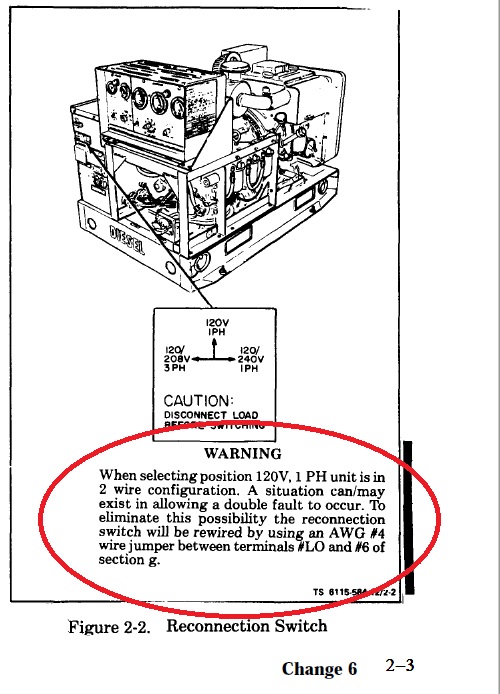

Connection warning. VERY important.
