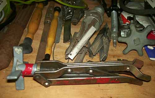

Well I am just going to dust off the manual and give her a go. I do have the correct tools for the seats. A complete set came with one of my buddies parts purchases. What I dont have is the special valve spring compressor. I guess I have to pull that damn manifold set off again! This will make the third time.
Any of you guys have a valve spring tool you will loan me? I will pay shipping both ways..
Also if any of you pro's want to share some secretes on doing this feel free to have at it! This is new territory for this shade tree mechanic.
Can the valve seats be changed with the engine in the truck? I wonder if I should have harnened seats put in if that is possible? If not it should last for a little bit shouldnt it? There is alway lead additive I guess..

The "big U-shaped things" are for OHV engines with the valves in the heads. It has to go around the head to apply pressure to the springs. For flatheads, you need the "pliers" type.

With the manifolds off, the U shaped one should work on a flathead as well. It may work better because it would give more room around the keeper area.

You have a point, there! Those "pliers" type spring compressors are a real pain to work with - even with the engine out of the vehicle where everything is "easy" to get to.

This is what the correct original valve spring compressor looks like.
http://www.g741.org/dcforum/User_files/44aa800873b4a933.jpg

Lane,
Here is the address of the one I have. I am sure people have better, but it might work.
http://www.sears.com/sr/javasr/product.do?pid=00947627000&vertical=Sears&BV_UseBVCookie=Yes
Copy and paste.
Jason

18. "RE: Valve spring compressor"
In response to message #13
You can get a correct reasonably priced valve spring compressor for use on L-head engines at NAPA. There is a possibility you could unstick them, but you can't do a proper clean up job in the guides with out removing them. The job is much easier if the manfold assembly is removed. It's also very easy to spot leaking valves, if the manifolds are off. The test will need to be done at night or in a VERY dark area during the day. Rotate the engine to TDC at compression when both valves would be closed on any cylinder. Turn off all lights, place a good lighted flashlight tightly against the intake port, then the exhaust port for that cylinder. If there is even a slight leak you will see light around the head of the valve. Progress through all 6 cylinders with this test, based on the info. you have shared, I believe you will likely see the reason for the low compression problem. Valve guide bore brushes are available at NAPA to clean up the guides. Once they are clean, insert the valve back into the guide & check for proper clearance. If it's excessive in accordance with the specs. in the manual, you'll need to replace the guide & the valve. The exhaust seats are replaceable in the field with the correct tooling. High nickel hardened seats designed for use with unleaded fuel are available. The intake seats are not replaceable as the seat is machined into the block deck. Machining can be done & new intake seats installed, but the engine block will have to be stripped & sent to an engine machining facility to perform this. The guides can be replaced in the field also, but you must have the proper guide drivers & reamers to perform this task. Guide reaming is a must after installation as in most cases the guides will mushroom slightly from the driving process. Trying to do this without reaming will likely cause you heartache. If you have to use force such as a puller to remove the valves, forget trying to re-use them, they will be warpped. Do it right, do it once. If I can help with further questions, feel free to give me a call at the shop, 704-474-4683.
www.mseriesrebuild.com
